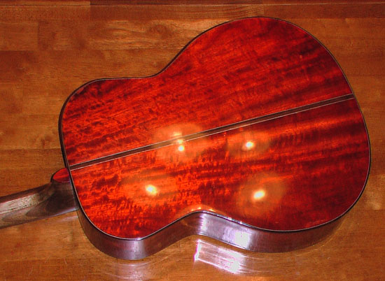

Here's the shot some of you requested from my earlier post, my #2 build using Padauk.  Thanks to all for the kind words on my original post!

Wow! That is stunning.

[QUOTE=MaxBishop] Wow! That is stunning.Max Bishop[/QUOTE]
Max is Right! Great job.
Do you have about ten more pictures?

My 2nd guitar was Padauk, but it certainly didn't look that pretty. Nice stuff there, and thanks for posting!

That is one pretty guitar! Almost looks 3D with the finish on it.
GREAT JOB !!!
